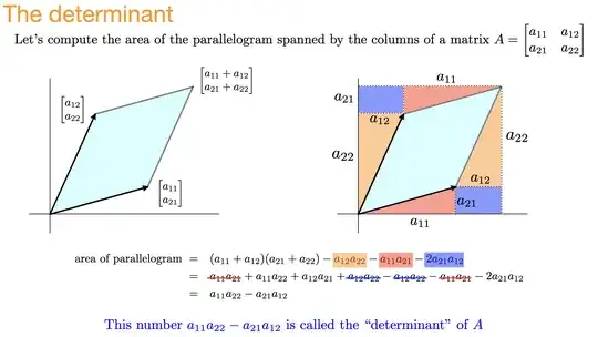

Here's a slide I made that gives a simple explanation for the determinant of a 2 by 2 matrix.
A similar but more laborious argument could be made for the determinant of a 3 by 3 matrix. At that point, we can guess that this interpretation holds for the determinant of an $n \times n$ matrix
littleO
  • 54,048
    Thanks for your answer. But this does not generalize to higher dimensions. As you mentioned, we can only "guess", not "proove or see". – Neo Aug 16 '21 at 11:46
