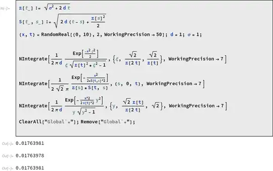

Above calculation indeed check out numerically.

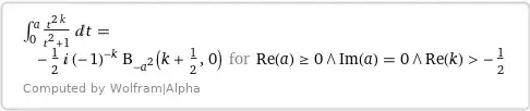

Besides, $$\int\limits_0^a \dfrac{t^{2k}\,\text dt}{t^2+1}\,\text dt = -\dfrac i2 (-1)^k \operatorname{B}\left(-a^2,k+\dfrac12,0\right),\tag5$$
$$\int\limits_0^a \dfrac{e^{-ct^2}\,\text dt}{t^2+1}\,\text dt = \sum\limits_{k=0}^\infty (-c)^k\int\limits_0^a \dfrac{t^{2k}\,\text dt}{t^2+1}\,\text dt =-\dfrac i2 \sum_{k=0}^\infty c^k\operatorname{B}\left(-a^2,k+\dfrac12,0\right),\tag6$$
