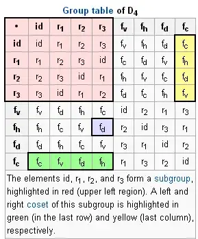

I know the definition, that $a$ and $b$ are conjugate if $gag^{-1}=b$ for some $g\in G$. But what is the intuition? Using a multiplication table (all the possible multiplications), how can I understand what a conjugacy class is?
For example, on Wikipedia you can see this table:
How can I relate the idea of a conjugacy class with this table?

It's not easy to see conjugacy in a group table, but try this:
Look at the $f_v$ row, and the $f_h$ column. $f_d$ is in both of them, and it's in the $r_1$ column of the $f_v$ row, and the $r_1$ row of the $f_h$ column. That tells you $f_vr_1=r_1f_h$ (since both equal $f_d$), which says $f_v=r_1f_hr_1^{-1}$, that is, $f_v$ and $f_h$ are conjugate.
In general, $a$ and $b$ are conjugate if there are elements $x$ and $y$ such that $x$ is in the $a$ row and the $y$ column, and also in the $b$ column and the $y$ row. If there are no such $x$ and $y$, then $a$ and $b$ aren't conjugate.
Of course, this is nothing but a restatement of the definition of conjugacy --- I'm just trying to restate it in terms of the group table, as requested.
