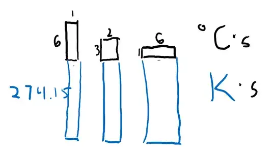

  • If we measure thing be their longitude so that London is essentially $0$ and San Francisco is $-120$ and New York is $-70$. Doe that mean $New York - San Francisco = -70 -(-120) = 50 = Tehran$? Does that make any sense? – fleablood Aug 08 '21 at 18:02
  • 11
    This is one reason that some find it useful to distinguish between $5^\circ \text{F}$ (measurement of temperature on Fahrenheit scale) and $5\text{F}^\circ$ (difference from $0^\circ \text{F}$ to $5^\circ \text{F}$). It's actually the notation I learned originally in high school physics, but since have not seen it in wide use... – Brian Moehring Aug 08 '21 at 18:04
  • The difference between temperature change and temperature can (I believe) be thought of as analogous to the difference between between position and distance. Distances are numbers and can be added and subtracted but positions are fixed points. We can consider the distance between points or add a distance to a point to indicate the point achieve by moving a distance from the point. But we can't add or subtract the points themselves. I'd interpret $5^\circ F-5^\circ F$ and starting a position 5 and shifting down 5. Result: $0^\circ F$ – fleablood Aug 08 '21 at 18:09
  • @BrianMoehring Nice! I've either never seen that or never noticed that. – fleablood Aug 08 '21 at 18:10
