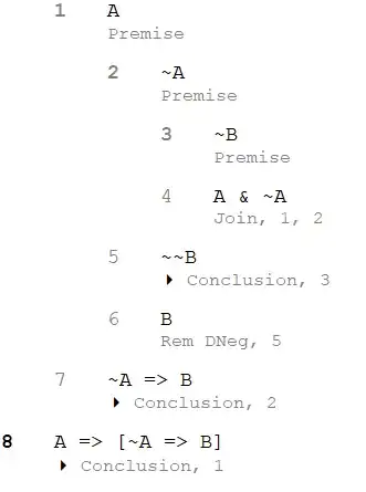

Consider the following example in which we formally prove the tautology A => [~A => B] for any logical propositions A and B. We will make use of a simplified form of natural deduction.
Here we make use of 4 different rules of inference. These rules are not tautologies. They are not logical statements composed of logical propositions and connectors as are tautologies. They are rules for generating strings of characters that themselves encode logical statements.
(Screenshot from my proof checker)
Here, the Premise Rule is applied on each of the first 3 lines. It allows us to, essentially, enter a what-if statement subject to various rules of syntax. On line 1, we enter the logical proposition A, asking what if A is true. On line 2 we enter the negation ~A, asking what if ~A is true. Similarly on line 3.
On line 4, we join together the statements on lines 1 and 2 to obtain a contradiction.
On line 5, we invoke the Conclusion Rule. Because the previous statement is a contradiction, we conclude that the premise on line 3 is false, i.e. that ~~B is true.
I hope the remaining lines and the rule of inference invoked on each are self explanatory.
