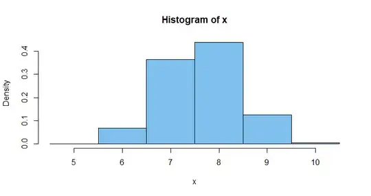

Below is a simulation in which st.20 contains the specified 20 stickers. Then, at each iteration ten stickers are taken at random without replacement from among the 20 and put into the first bag. The number of uniquely different stickers in that bag is determined.
The goal is for that number to be 10. The proportion of the million iterations with 10 uniquely different stickers is $0.0055 \pm 0.00015,$ which is in agreement with $2^{10}/{20 \choose 10}.$

summary(x) Min. 1st Qu. Median Mean 3rd Qu. Max. 5.00 7.00 8.00 7.63 8.00 10.00
hist(x, prob=T, br=(4:10)+.5, col="skyblue2")
