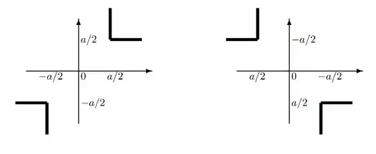

First, let's observe the region in the Cartesian plane where $f(x, y) \ge a$ and $f(x, y) \le -a$, respectively:
And therefore \begin{align*} \mathbb{P}(f(X, Y) \ge a) &= \mathbb{P}\left(X \ge \frac{a}{2}, Y \ge \frac{a}{2}\right) + \mathbb{P}\left(X \le -\frac{a}{2}, Y \le -\frac{a}{2}\right) \\ &= \mathbb{P}\left(X \ge \frac{a}{2}\right)^2 + \mathbb{P}\left(X \le -\frac{a}{2}\right)^2 \end{align*} and \begin{align*} \mathbb{P}(f(X, Y) \le a) &= \mathbb{P}\left(X \ge \frac{a}{2}, Y \le -\frac{a}{2}\right) + \mathbb{P}\left(X \le -\frac{a}{2}, Y \ge \frac{a}{2}\right) \\ &= 2\mathbb{P}\left(X \ge \frac{a}{2}\right) \left(X \le -\frac{a}{2}\right) \end{align*} Then, we need the lemma that \begin{align*} \mathbb{E}[A] = \int_0^\infty [\mathbb{P}(A \ge a) - \mathbb{P}(A \le -a)]da \end{align*}
