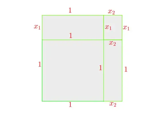

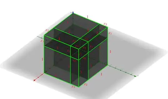

So, here is my attempt at giving a visual intuition, which of course is not a proof. Let's start with the case, where we have only two variables, $x_1$ and $x_2$. We can imagine the product $(1+x_1)(1+x_2)$ as the area of a rectangle with sidelengths $1+x_1$ and $1+x_2$, like here: You can see from here that we can divide our rectangle into $4$ different rectangles of area $1\cdot 1$, $1\cdot x_1$, $1\cdot x_2$ and $x_1\cdot x_2$ and so $$(1+x_1)(1+x_2) = 1 + x_1+x_2+x_1 x_2.$$ How about three variables, $x_1,x_2$ and $x_3$? Well, now the product $(1+x_1)(1+x_2)(1+x_3)$ describes a cuboid with sidelengths $1+x_1, 1+x_2$ and $1+x_3$ as shown here:
The $1\cdot 1\cdot 1$ cube is hidden behind the remaining cuboids. Again, counting the volume of the other cuboids, we get $$(1+x_1)(1+x_2)(1+x_3) = 1 + x_1+x_2+x_3 + x_1x_2+x_2x_3 + x_3x_1 + x_1x_2x_3.$$
For higher dimensions, things get a bit messy with the visualisation.
