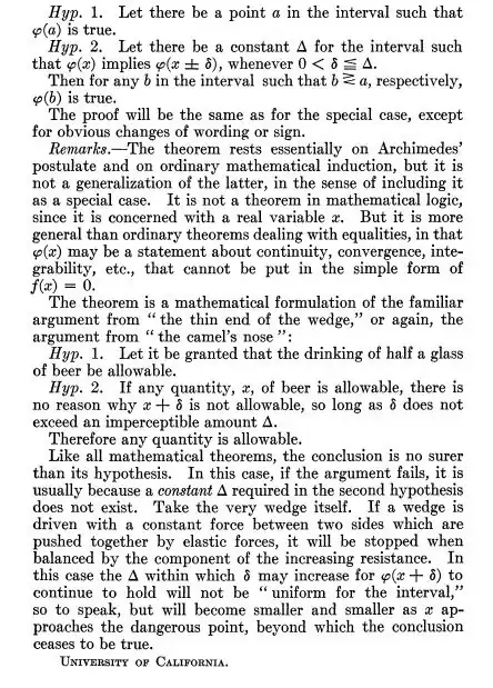

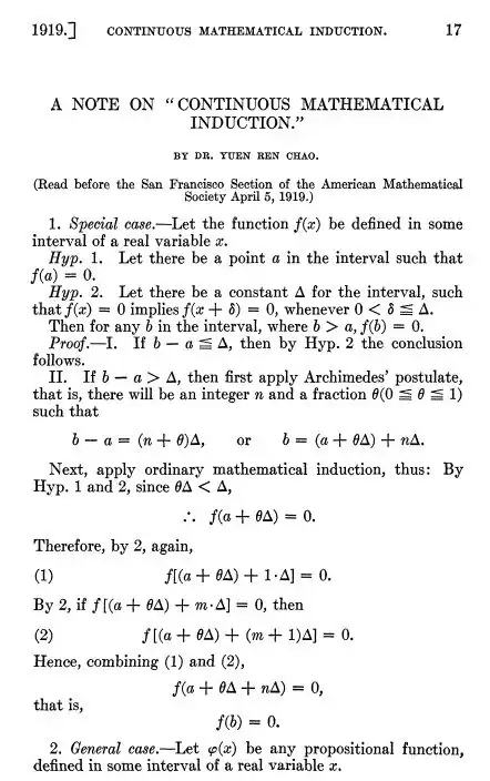

28
Such results on continuous induction are folklore dating back over a century - much older than the references in the Kalantari paper referenced by Pete L. Clark. I once had a large file of papers on this topic but, alas, it's long lost. But I can still recall one old paper [1] because the author was the world-renowned multi-talented Chinese linguist Yuen Ren Chao. If memory serves correct he did his thesis under Sheffer at Harvard on aspects of the continuum, so his BAMS paper was probably an offshoot of his thesis. Since Project Euclid seems to be having intermittent problems I have appended the short paper below. For some biographical information on Chao see here1 and here2.
[1] Yuen Ren Chao. A note on “Continuous mathematical induction".
Bull. Amer. Math. Soc. Volume 26, Number 1 (1919), 17-18. alt text alt text
