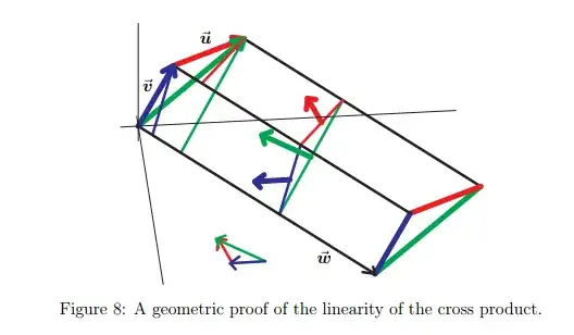

According to Prof. Josiah Willard Gibbs, one of the founders of Vector Analysis, the cross (or skew) product is defined as follows in his 1881 pamphlet Vector Analysis - Arranged for the use of Students in Physics
Definition: The skew product of the vector A into the vector B is the vector quantity C whose direction is the normal upon that side of the plane of A and B on which rotation from A to B through an angle of less than one hundred and eighty degrees appears positive or counter- clockwise ; and whose magnitude is obtained by multiplying the product of the magnitudes of A and B by the sine of the angle from A to B.
This definition, coming from the horse's mouth, as it were, is a geometric definition. Why then, do we in the 21st c. insist on defining it in terms of determinants. The determinant "definition" is a direct consequence of the geometric definition and the distributivity of cross products $$\vec{\mathbf{w}}\times(\vec{\mathbf{u}}+ \vec{\mathbf{v}}) = \vec{\mathbf{w}}\times\vec{\mathbf{u}}+\vec{\mathbf{w}}\times\vec{\mathbf{v}}$$ $$(\vec{\mathbf{u}}+ \vec{\mathbf{v}})\times\vec{\mathbf{w}} = \vec{\mathbf{u}}\times\vec{\mathbf{w}}+\vec{\mathbf{v}}\times\vec{\mathbf{w}}$$ now try to expand $$(a_1\vec{\mathbf{i}}+a_2\vec{\mathbf{j}}+a_3\vec{\mathbf{k}})\times(b_1\vec{\mathbf{i}}+b_2\vec{\mathbf{j}}+b_3\vec{\mathbf{k}})$$ to see that cross products, in fact, distribute over addition, see a geometric proof on page 9 of http://www.math.oregonstate.edu/bridge/papers/dot+cross.pdf
