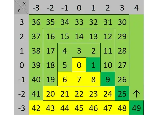

If we put the natural numbers on the Ulam Spiral this wayenter image description here (Sorry I couldn't find a picture where the spiral starts at $0$, so I just put the wikipedia picture here. Just replace $n$ with $n-1$)
Then what is the formula for the cartesian coordinate on the integer lattice where each natural number lies?

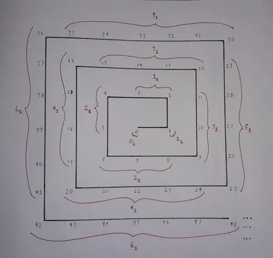

So- enter image description here
(Please forgive me. I cannot create pictures, so I just drew it. But I hope you understand that what $L_1$ and $L_2$ are)
Here I tried to show how each segment looks like on the spiral.
A bit of investigations gives us the result-
$\begin{align}&L_1=\{L^2,\cdots,L^2+L-1\}\\&L_2=\{(L+1)^2-(L+1),\cdots,(L+1)^2-1\}\end{align}$

Verifying the formula in python, gives the expected result as in the picture:
36  35  34  33  32  31  30
37  16  15  14  13  12  29
38  17  4   3   2   11  28
39  18  5   0   1   10  27
40  19  6   7   8   9   26
41  20  21  22  23  24  25
42  43  44  45  46  47  48  49
