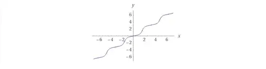

An overall continuous anti-derivative function valid for $x\in \mathbb{R} $ is instead
$$\int \frac{1}{a^2\cos^2{x}+b^2\sin^2{x}} dx = \frac{1}{ab}\arctan{\left(\frac{b}{a}\tan{x}\right)} +\pi \left[{\frac x\pi+\frac12\text{sgn}(x)}\right]+C $$
enter image description here where $[]$ represents the integer function.
