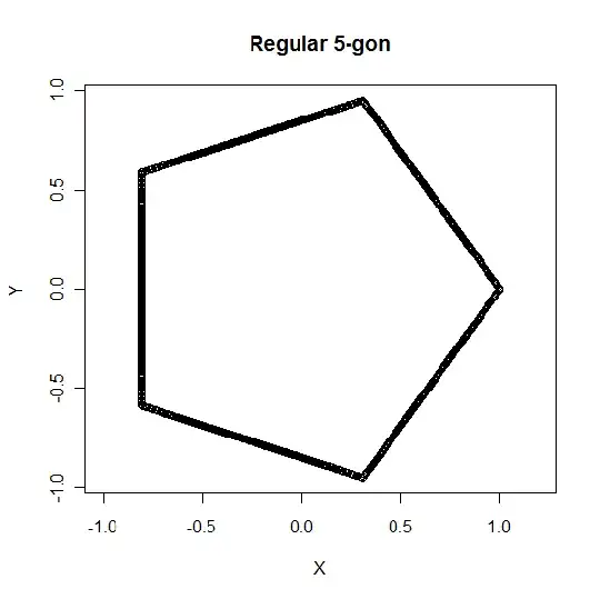

Here's a parametric equation I have made for a regular $n$-gon, coded in R:
n=5;
theta=(0:999)/1000;
r=cos(pi/n)/cos(2*pi*(n*theta)%%1/n-pi/n);
plot(r*cos(2*pi*theta),r*sin(2*pi*theta),asp=1,xlab="X",ylab="Y",
main=paste("Regular ",n,"-gon",sep=""));
And picture:
5-gon
The formula I used is
$$\displaystyle r=\frac{\cos\left(\frac{\pi}{n}\right)}{\cos\left(\left(\theta \mod \frac{2\pi}{n}\right) -\frac{\pi}{n}\right)} \; .$$
This equation is actually just the polar equation for the line through the point $(1,0)$ and $(\cos(2\pi/n),\sin(2\pi/n))$ which contains one of the edges. By restricting the range of the variable $\theta$ to the interval $[0,2\pi/n[$, you will in fact just get that edge. Now, we want to replicate that edge by rotating it repeatedly through an angle $2\pi/n$ to get the full polygon. But this can also be achieved by using the modulus function and reducing all angles to the interval $[0,2\pi/n[$. This way, you get the polar equation I propose.
So, using polar plots and the modulo function, it's pretty easy to make regular $n$-gons.

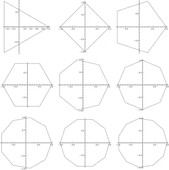

Here is another parametric equation for a regular $n$-gon with unit radius:
$$\begin{align*}x&=\cos\left(\frac{\pi}{n}\right)\cos\left(\frac{\pi}{n}(2\lfloor u\rfloor+1)\right)-(2u-2\lfloor u\rfloor-1)\sin\left(\frac{\pi}{n}\right)\sin\left(\frac{\pi}{n}(2\lfloor u\rfloor+1)\right)\\y&=\cos\left(\frac{\pi}{n}\right)\sin\left(\frac{\pi}{n}(2\lfloor u\rfloor+1)\right)+(2u-2\lfloor u\rfloor-1)\sin\left(\frac{\pi}{n}\right)\cos\left(\frac{\pi}{n}(2\lfloor u\rfloor+1)\right)\end{align*}$$
for $0 \leq u \leq n$.
The provenance of this set is a bit more transparent if we switch to matrix-vector notation:
$$\begin{pmatrix}\cos\left(\frac{\pi}{n}(2\lfloor u\rfloor+1)\right)&-\sin\left(\frac{\pi}{n}(2\lfloor u\rfloor+1)\right)\\\sin\left(\frac{\pi}{n}(2\lfloor u\rfloor+1)\right)&\cos\left(\frac{\pi}{n}(2\lfloor u\rfloor+1)\right)\end{pmatrix}\begin{pmatrix}\cos\left(\frac{\pi}{n}\right)\\(2u-2\lfloor u\rfloor-1)\sin\left(\frac{\pi}{n}\right)\end{pmatrix}$$
and we see that the construction involves rotating and copying the line segment joining the points $(\cos\left(\frac{\pi}{n}\right),\pm\sin\left(\frac{\pi}{n}\right))$ $n$ times around a circle.
Here's sundry Mathematica code:
GraphicsGrid[Partition[Table[
  ParametricPlot[Through[{Re, Im}[
        (Cos[Pi/n] + I (2u - 2 Floor[u] - 1)Sin[Pi/n])*
         Exp[(I Pi/n) (2 Floor[u] + 1)]],
     {u, 0, n}], {n, 3, 11}], 3]]
regular polygons, 3-11

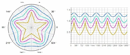

A more general formula exists, for star polygon too and its smoother variations:
$$1=\frac{\sqrt{x^2+y^2} \cos \left(\frac{2 \sin ^{-1}\left(k \cos \left(n \tan ^{-1}(x,y)\right)\right)+\pi m}{2 n}\right)}{\cos \left(\frac{2 \sin ^{-1}(k)+\pi m}{2 n}\right)}$$
or, with polar coordinates:
$$\rho = \frac{\cos \left(\frac{2 \sin ^{-1}(k)+\pi m}{2 n}\right)}{\cos \left(\frac{2 \sin ^{-1}(k \cos (n \phi ))+\pi m}{2 n}\right)}$$
where
$\phi$ - angle;
$\rho$ - radius;
$n$ - number of convex vertices;
$m$ - determines how many vertices the sides will lie on one straight line;
$k$ - hardness - for $k=0$ we get a circle regardless of other parameters, for $k=1$ - a polygon with straight lines, with intermediate values from $0$ to $1$ - intermediate figures between the circle and the polygon.
For more details see this paper (at russian)
sample image sample image

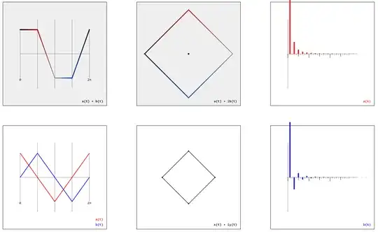

In the context of this question you may define for a given number $n$ some (Fourier) coefficients by these sensible equations (as you have asked for):
$a^{(n)}_k \sim \begin{cases} +k^{-2} & \text{ for } k \equiv 1 \pmod n\\ +k^{-2} & \text{ for } k \equiv (n-1) \pmod n\\ 0 & \text{ otherwise } \end{cases}$
$b^{(n)}_k \sim \begin{cases} +k^{-2} & \text{ for } k \equiv 1 \pmod n\\ -k^{-2} & \text{ for } k \equiv (n-1) \pmod n\\ 0 & \text{ otherwise } \end{cases}$
Then you calculate the functions $a^{(n)}(t)$ and $b^{(n)}(t)$ like this:
$a^{(n)}(t) \sim \sum_{k=0}^\infty a^{(n)}_k\cos(kt)$
$b^{(n)}(t) \sim \sum_{k=0}^\infty b^{(n)}_k\sin(kt)$
Finally you draw the curve $t \mapsto a^{(n)}(t) + ib^{(n)}(t)$ in the complex plane – and get your desired regular $n$-gon.
As an example for $n=4$:
See more examples in the gallery here.

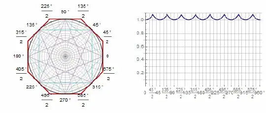

Reposted from PolymathProgrammer.com, my answer to my own initial query. Generated mostly on my own after some initial help from a friend (Jason Schmurr) and my dad (Russell Gmirkin)
I believe I've solved my own inquiry. The following are functions that, when graphed in polar coordinates render lovely polygons.
In fact, I’ve got 3 versions (6 if you consider rotation a factor; to either align a vertex or the midpoint of a side with $\theta=0$). One with circumradius = 1 (as vertices $\to \infty$, polygons expand outward toward the circumscribed circle), one with apothem = 1 (as vertices $\to \infty$, polygons collapse inward toward the inscribed circle) and one with the midpoint between circumradius & apothem = 1 (as vertices $\to \infty$, both the maxima and minima, thus the circumscribed and inscribed circles, collapse toward that ‘midpoint radius’).
I’d be interested to know whether this approach, describing the radius of a polygon as a periodic function, has any precedent (has anyone else done this, or am I the first)? I’ve been working on this idea for some time (on and off for years), but just recently overcame some stumbling blocks with a little help from a friend and my dad. Most of the legwork was my own, though.
The relatively final form(s) appear to be:
(n-gon, circumradius=1, unrotated)
1/(((Sec[pi/v]-1)/(Sec[Pi/4]-1))Abs[Cos[(v*x)/4]]+((Sec[pi/v]-1)/(Sec[Pi/4]-1))Abs[Cos[((v*x)/4)-(Pi/2)]]-((Sec[pi/v]-1)/(Sec[Pi/4]-1))+1)
(n-gon, circumradius=1, rotated $-\pi/4$)
1/(((Sec[pi/v]-1)/(Sec[Pi/4]-1))Abs[Cos[((v*x)/4)-(Pi/4)]]+((Sec[pi/v]-1)/(Sec[Pi/4]-1))Abs[Cos[((v*x)/4)-(3Pi/4)]]-((Sec[pi/v]-1)/(Sec[Pi/4]-1))+1)
(n-gon, function centered around unit circle, unrotated)
((Sec[Pi/v]+1)/2)/(((Sec[Pi/v]-1)/(Sec[Pi/4]-1))Abs[Cos[((v*x)/4)]]+((Sec[pi/v]-1)/(Sec[Pi/4]-1))Abs[Cos[((v*x)/4)-(Pi/2)]]-((Sec[pi/v]-1)/(Sec[Pi/4]-1))+1)
(n-gon, function centered around unit circle, rotated $-\pi/4$)
((Sec[Pi/v]+1)/2)/(((Sec[pi/v]-1)/(Sec[Pi/4]-1))Abs[Cos[((v*x)/4)-(Pi/4)]]+((Sec[pi/v]-1)/(Sec[Pi/4]-1))Abs[Cos[((v*x)/4)-(3Pi/4)]]-((Sec[pi/v]-1)/(Sec[Pi/4]-1))+1)
(n-gon, apothem=1, unrotated)
Sec[Pi/v]/(((Sec[pi/v]-1)/(Sec[Pi/4]-1))Abs[Cos[(v*x)/4]]+((Sec[pi/v]-1)/(Sec[Pi/4]-1))Abs[Cos[((v*x)/4)-(Pi/2)]]-((Sec[pi/v]-1)/(Sec[Pi/4]-1))+1)
(n-gon, apothem=1, rotated $-\pi/4$)
Sec[Pi/v]/(((Sec[pi/v]-1)/(Sec[Pi/4]-1))Abs[Cos[((v*x)/4)-(Pi/4)]]+((Sec[pi/v]-1)/(Sec[Pi/4]-1))Abs[Cos[((v*x)/4)-(3Pi/4)]]-((Sec[pi/v]-1)/(Sec[Pi/4]-1))+1)
Don’t know whether they simplify at all to something less complicated… Even if not, they’re beauties!
Examples:
3-gon: here
4-gon: here
5-gon: here
If it's a unique solution and I'm first to it, I submit these as the Gmirkin Polygon Radius Function(s) (or some suitably nifty sounding name that’s not too cumbersome). *Smile* Heh.
I may write them up formally for publication at some point, once a few previous engagements clear up, assuming they’ve not previously been published or some directly correlated function has already been published elsewhere. (If so, I’d like to know when, where and by whom; for academic curiosity’s sake.)
It is my belief that a similar function exists for describing 3D Polyhedrons of some description(s). Though, I have not yet even attempted such a case and will probably stick to 2D cases for now. I can also tell you that if you vary the phase shift of the denominator [Abs[Cos[]]] terms by differing amounts (though not both by some multiple of $\pi/4$, $\pi/2$, etc.), you can also reproduce rectangles, isosceles triangles, etc. In some cases you can also generate diamond shapes by varying some other parameters. It's s surprisingly robust solution, as I'd hoped. Lord knows it's taken me a few years of false starts to get at the correct combination of functions. Though, I learned plenty along the way, much of which helped me generalize to all polygons from the square case a friend solved at my behest a week or two ago.
Here's hoping this is an interesting, unique new solution that's viable and notable. (One can hope!)
Sorry the post is a bit lengthy... ;)
Best,
~Michael Gmirkin
Edit:
Sorry. Jumped the gun slightly.
I retract the above equations. At the behest of someone on another site, I checked in Wolfram Alpha at a few data points. While it appears to work for the Square case (where the coefficients and corrective term basically cancel out), it doesn't work for other cases, but is slightly off. I think I've got the coefficients wrong. Will have to poke around a bit more in the maths to see if it's possible to get a technically correct exact solution.
The graphs were so close as to fool me into thinking they were exact for all cases. Will get back to you if/when I get a technically correct solution. 'Til then... I still believe there is a valid function, since the Square case is technically correct @ 1/(Abs[Sin(x)]+Abs[Cos[x]]) or 1/(Abs[Cos[x]]+[Abs[Cos[x-(Pi/2)]]]). Just need the technically correct coefficient... will work on it as I've got some time. But, for now, the incorrect versions are darned close! ;o) Enough to fool most people (including me, apparently).
