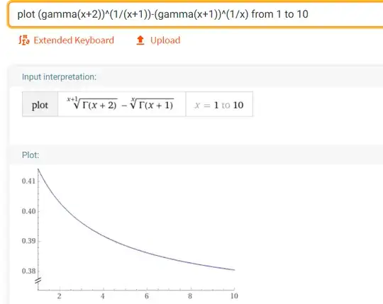

Use Wolfram we have that $$a_1=\sqrt[2]{2!}-\sqrt[1]{1!}=0.4142135623730950488016887242096980785696718753769480731766797379$$ $$a_2=\sqrt[3]{3!}-\sqrt[2]{2!}=0.4029070304590446100895230321175624238585385877642715983046545599$$ $$a_3=\sqrt[4]{4!}-\sqrt[3]{3!}=0.3962432465685035259263687905534027946796259019185992795523061114$$ $$a_4=\sqrt[5]{5!}-\sqrt[4]{4!}=0.3918072452967087075081863770479530310194707973034612596596597742$$,... an so on. From this data we can guess that $a_n$ is decreasing. More generally, let $$f(x)=\sqrt[x+1]{\Gamma(x+2)}-\sqrt[x]{\Gamma(x+1)},$$ where $\Gamma(x)$ is the Gamma function $$\Gamma(x)=\int_0^\infty e^{-t}t^x\dfrac{dt}{t}.$$ Plot the graph of $f(x)$, we can see that $f$ decreases. Can anyone prove this conclusion?
