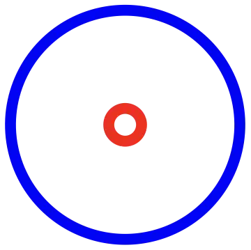

The first equation is correct and the second wrong.
Just study this figure where $f(x) - g(x)$ is the same for the red and blue. Your second equation incorrectly says they have the same area.
