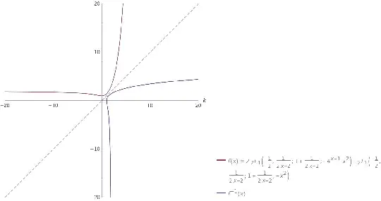

Graph of arc length from 1 to 2 of $x^k$: enter image description here

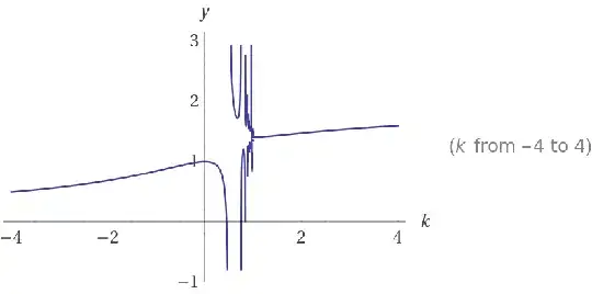

Graph of arc length from 0 to 1 of $x^k,x\ge0$: enter image description here
