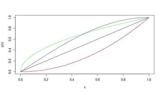

As others have elaborated, $\frac{dy}{dx}$ is not a ratio, but a rate, and $\frac{dy}{dx}$ is the limit of $\frac{\Delta y}{\Delta x} = \frac{f(x+t) - f(x)}{x - t}$ as $t$ approaches 0. This is a very good foundation to build, but personally I didn't fully understand this definition until I had a few math classes above Calculus under my belt. So I'd like to present a less rigorous but hopefully more intuitive argument.
$\frac{\Delta y}{\Delta x}$ is a generally a specific value for some pair of $x$'s(or $y$'s). For example, what is the difference in $y$ from $x =0$ to $x=1$ for some function? Let's look at four function
$$y = black(x) = x$$ $$y = red(x) = x^2$$ $$y = green(x) = \sqrt{x}$$ $$y = blue(x) = \sin(x * \frac{\pi}{2})$$
If we look from 0 to 1, each of these has $\frac{\Delta y}{\Delta x} = \frac{y(1) - y(0)}{1 - 0} = 1$. However, if we plot each of these we see that each of them are very different functions, even from 0 to 1.
While the ratio of change in $y$ vs change in $x$ is useful, it does not provide a complete picture of the rate of change of a function. The derivative allows us to define the rate of change in general, and also at any particular point $x$ for some function of $x$. This is of considerable importance among a variety of fields as your functions become more and more complex.
