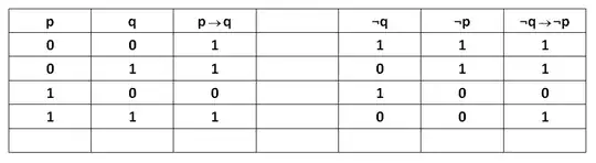

Your class probably defines $A\equiv B$ as $(A\to B)\land (B\to A)$, so you can treat it that way for the tableau.

2You used Truth Table to prove. I want to know how to prove the same thing using tableau (http://en.wikipedia.org/wiki/Method_of_analytic_tableaux). – Mike Jun 12 '13 at 00:12
