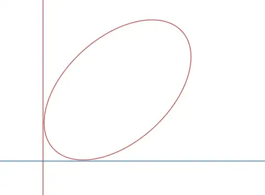

An ellipse with major axis $4$ and minor axis $2$ touches both the coordinate axes. Locus of its Center and Focus is?

Note There are many solutions available on internet, but they all did this with the same method of taking axis of ellipse parallel to coordinate axis.
I don't want to do using that method. I want it for slanted ellipse as shown in attached image.

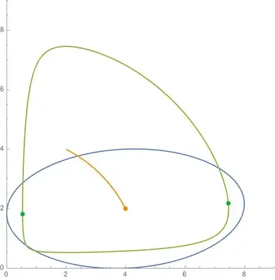

Where are the foci? We can first observe that they are located at some point along the line joining $(x(0), y(0))$ and $(x(\pi), y(\pi))$, so they have coordinates of the form $$(1-\lambda)(x(0), y(0)) + \lambda (x(\pi), y(\pi))$$ for $$\lambda = \frac{4 + 2 \sqrt{3}}{8} = \frac{2 + \sqrt{3}}{4}, \quad \text{and} \quad \lambda = \frac{2 - \sqrt{3}}{4}.$$ We again skip the calculation and show the result: $$(x_f(u), y_f(u)) = 2 \left(\sqrt{3} \cos u + \sqrt{4 \cos^2 u + \sin^2 u}, \sqrt{3} \sin u + \sqrt{\cos^2 u + 4 \sin^2 u} \right). \tag{1}$$ Note that this curve gives the locus of both foci, where $u$ and $u + \pi$ represent the location of each focus for a given rotation angle $u$.
All put together, we can visualize these loci in the following animation:
The conversion of the parametric formula to an implicit curve is tedious but not intractable; one would start with computing the square, then show that the square of the locus satisfies $$(x + y)(16 + xy) = 64 xy.$$
One approach to converting the locus is to note that we can write $$(x_f(u), y_f(u)) = \left(2 \sqrt{3} \cos u + \sqrt{(2 \sqrt{3} \cos u)^2 + 4}, 2 \sqrt{3} \sin u + \sqrt{(2 \sqrt{3} \sin u)^2 + 4} \right),$$ therefore $x_f(u)$ and $y_f(u)$ are roots of the quadratics $$x^2 - (4 \sqrt{3} \cos u) x - 4 = 0, \\ y^2 - (4 \sqrt{3} \sin u) y - 4 = 0,$$ or equivalently, $$48 \cos^2 u = \frac{(4-x^2)^2}{x^2}, \quad 48 \sin^2 u = \frac{(4-y^2)^2}{y^2}.$$ Thus $$48 = \frac{(4-x^2)^2}{x^2} + \frac{(4-y^2)^2}{y^2},$$ and the rest is an exercise in algebra.
