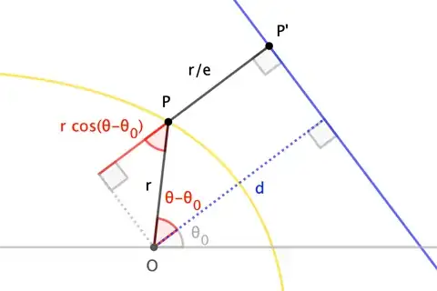

In the figure, $O$ is the focus, $P$ is the point on the conic, and $P'$ is the projection of $P$ onto the directrix, the line at distance $d$ from $O$ whose normal makes an angle $\theta_0$ with the $x$-axis.
Writing $r$ for $|OP|$ and $\theta$ for the angle $\overline{OP}$ makes with the $x$-axis (that is, taking $(r,\theta)$ to be the polar coordinates of $P$), we have $$d = \frac{r}{e}+r\cos(\theta-\theta_0) \quad\to\quad r = \frac{de}{1+e\cos(\theta-\theta_0)} \tag{1}$$ It's customary to replace $de$ with, say, $\ell$ for the length of the semi-latus rectum (the length $r$ when $\overline{OP}$ is parallel to the line; ie, when $\theta-\theta_0=90^\circ$). $$r = \frac{\ell}{1+e\cos(\theta-\theta_0)} \tag{2}$$ This allows the formula to apply to circles, as well. $\square$
For the corresponding Cartesian formulation, we square relation $(0)$ and write $$x^2+y^2=e^2 \left(x\cos\theta_0+y\sin\theta_0-d\right)^2 \tag{3}$$ Expanding and re-arranging, we have $$\begin{align} 0 &= x^2(1-e^2\cos^2\theta_0)+y^2(1-e^2\sin^2\theta_0)-2xye^2\sin\theta_0\cos\theta_0 \\ &\quad+2xde^2\cos\theta_0+2yde^2\sin\theta_0 -e^2d^2 \end{align} \tag{4}$$ Again, we can replace $de$ with semi-latus rectum $\ell$ to get a version that works with circles: $$\begin{align} 0 &= x^2(1-e^2\cos^2\theta_0)+y^2(1-e^2\sin^2\theta_0)-2xye^2\sin\theta_0\cos\theta_0 \\ &\quad+2xe\ell\cos\theta_0+2ye\ell\sin\theta_0 -\ell^2 \end{align} \tag{5}$$ I should note that multiplying-through by some arbitrary (non-zero) constant scales the coefficients of $(5)$ without affecting the conic itself. Accordingly, when comparing the general second-degree equation $Ax^2+Bxy+Cy^2+Dx+Ey+F=0$, we have to allow for the constant, say $k$, so that $A=k(1-e^2\cos^2\theta_0)$, $C=k(1-e^2\sin^2\theta_0)$, etc. This adds some complexity to retrieving the geometric parameters from the coefficients; see, for instance, this answer.
