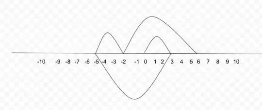

I am trying to understand the idea behind it by using an analogy of movements along the number line.
E.g. if we want to apply the process for $8$ and $3$ then it could be something like:
But I am confused on the process itself. I think the idea is that we move around in steps of the two numbers we are working on until we reach some limit, but I am not clear on how the process would work.

    I think it must be describing the original Euclidean algorithm: repeatedly subtract the larger number from the smaller until the two numbers are equal. This is the gcd. The algorithm described, if taken literally, wouldn't converge, would it? – saulspatz Jun 04 '21 at 18:22
  • @saulspatz: I was under the impression that by these subtractions/movements we would end up shifting along the number line till we either end in $1$ or $0$ and then it stops. E.g. if we end up in $1$ then $1 + 8 = 9 - 3 - 3 - 3 = 0$ but I am not clear on how to do this in the general way or if I am totally confused – Jim Jun 04 '21 at 18:57
  • I see that I said "subtract the larger from the smaller" where I meant, of course, "subtract the smaller from the larger". I don't see how the literal algorithm works. Say we have $(5,15)$. The algorithm seems to give $$(5,15)\to(5,10)\to(-5,10)\to(-5,15)\to(-20,15)\to\cdots$$ Perhaps one is supposed to take absolute values. Then it's Euclid's algorithm again. – saulspatz Jun 04 '21 at 19:06

A number line may not offer a useful context for understanding anthyphairesis because it works with a single unit corresponding to the interval between 0 and 1. anthyphairesis and the Euclidean algorithm entail relations between multiple units: first a dividend unit and a divisor unit and also remainder unit(s) if the dividend is not a multiple of the divisor. So parallel line segments are better resources. But the units need to be explicitly labeled.
