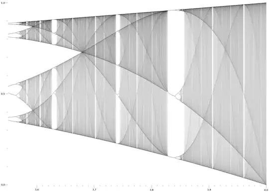

Is there an equation for the high density curves in the chaotic regions of the bifurcation diagram for the logistic map? I'm talking about the sinusoidal-looking dark curves in the following picture. what causes these to arise?

2The are the critical curves defined here. See also, The road to chaos is filled with polynomial curves. – Mark McClure Jun 04 '21 at 02:40
1Also see https://math.stackexchange.com/questions/2390324/what-are-the-lines-on-a-bifurcation-diagram – Andrew Pareles Jun 04 '21 at 06:59
