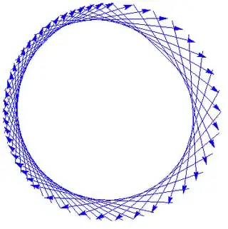

For example, when $t$ ran from $1$ to $100$ in steps of $0.2$ we retrieve the following cardioid-like curve: cardioid-like curve

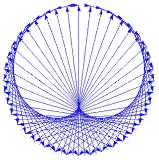

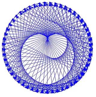

Many such curves can be generated by varying the functions $f$ and $g$ slightly, for example: another cardioid-like curve another cardioid-like curve

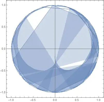

One can retrace and plot the curve as a family of lines using the following parametric function:
r[t_] := (x = -Sin[t]; y = Cos[t]; {x, y});
f[n_] := n*4;
g[n_] := n/2^Floor[Log[n]];
parametricFunc[t_, u_] := (P1 = r[2 Pi*g[t]];
   P2 = r[2 Pi*g[f[t]]]; {P1[[1]] + u*(P2[[1]] - P1[[1]]),
    P1[[2]] + u*(P2[[2]] - P1[[2]])});
ParametricPlot[parametricFunc[t, u], {t, 0.01, 1}, {u, 0, 1}]
It produces the following definition:

  • @Blue: I just checked it and can confirm that the first curve is actually using $f(x)=4x$. The last curve (the one with the heart) is for example using $f(x)=3x$ and $g(x)=\frac{x}{2^{\lfloor\ln(x)\rfloor}}$ –  May 31 '21 at 04:32

    @EldarSultanow: Hmm ... I can't (yet) tell why either of us would be off by a factor of $2$. ... Here's where I am on this: $\lfloor\ln x\rfloor$ over successive intervals $I_k:=[e^k,e^{k+1})$ (for integer $k$) is constant (namely, $k$). Writing, say, $f(x)=ax$, we have $g(f(x))=2^{-k}\cdot ax=a\cdot g(x)$ on $I_k$. This implies $P_2$ moves around the circle at $a$-times the speed of $P_1$ (for each $k$!). It is "known" (and readily proven) that the resulting envelope is a cardioid when $a=2$; your first image even appears to illustrate this. ... Perhaps I'll see the error after a break. – Blue May 31 '21 at 06:57

  • @EldarSultanow: See Wikipedia's "Cardioid" entry, under Cardioid as a pencil of lines. (Note that the text there observes "The second point [of the two defining the chord tangent to the curve] is moved by double velocity", which is consistent with my comment about $a=2$.) – Blue May 31 '21 at 12:06
  • ok - I checked my notebook and replaced $4$ with $2$ and as you said I get also a cardioid. So both factors work. –  May 31 '21 at 12:41

    @EldarSultanow: That may be correct; I haven't checked. ... Ultimately, your curve appears to be the union of cardioid-like envelopes of chords whose endpoints traverse the circle at different (but individually-constant) rates. The specific rates, and extents of arcs, depend upon the subdivided $I_k$ intervals. The whole thing is a bit of a mess near zero (where there are infinitely-many tiny intervals); also, using a base-$e$ log as an exponent on $2$ just adds to the mess. I'm afraid my enthusiasm for sorting-out the nuances of this curiosity has evaporated, but I wish you luck. Cheers! :) – Blue Jun 06 '21 at 00:18

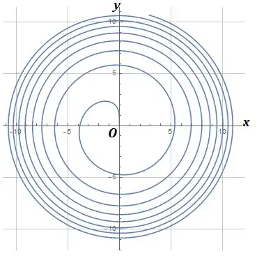

which plots to a spiral $(0<t< 50) $ before even going to its envelope.

  • The curve can be understood as a family of lines. I do not get a spiral but I can provide you the parametric function and its plot. For this I extend my question to add a picture. Just a moment. –  May 31 '21 at 04:39
  • Thank you very much for your help. In order to make it more retracable I added a small snippet (Mathematica) containing four lines of code that specify and plot the parametric function. –  May 31 '21 at 04:50
  • When I remove the floor operation from $g(x)$, I get the spiral too. –  May 31 '21 at 05:32
