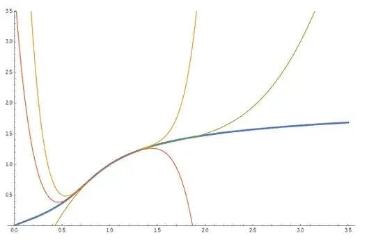

Since the series has no constant terms, it is possible to express the inverse function $f^{-1} (x)$ by Series Reversion
$$f^{-1}(x)=x-(-1+x)^2+ \frac{1}{2}(-1+x)^3+\frac{7}{6}(-1+x)^4-\frac{17}{4} (-1+x)^5+O(x^6) $$
