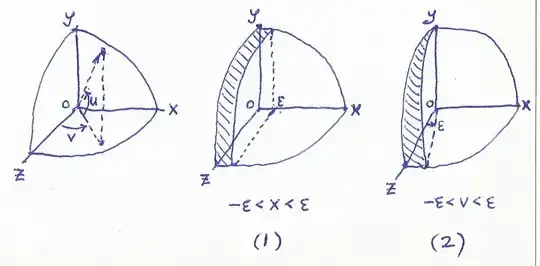

In the present problem, we're contrasting quantities defined by two different convergent sequences of sets, even though these sequences are not explicit in the notation. The key point is that although the limit events $\{X=0\}$ and $\{V=0\}$ are equivalent, the sequences converging to them are not:
(1) $E(|Y|\mid X=0)=\int_{\mathbb{R}} |y|f_{Y\mid X}(y\mid x) dy=2/\pi.$ In this case, the sets converging to $\{X=0\}$ are of form $\{-\epsilon<X<\epsilon\},$ carving from the hemisphere thin half-disks.
(2) $E(|Y|\mid V=0)=\int_{\mathbb{R}} |y|f_{Y\mid V}(y\mid v) dy=1/2.$ In this case, the sets converging to $\{V=0\}$ are of form $\{-\epsilon<V<\epsilon\},$ carving from the hemisphere thin wedges.
Here are some exaggerated sketches showing just one octant:
Some intuition: Since the distribution is uniform on the surface of the sphere, the wedge-shape (2) will --compared to (1)-- give more weight to the smaller $|y|$-values near the "equator" and less weight to the larger $|y|$-values near the "poles", so we expect to find $E(|Y|\mid X=0)>E(|Y|\mid V=0)$, which is indeed the case.
