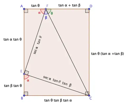

trigonograph
Let $AF=\tan\theta$. Then, obtain expressions for $AE, EF, EC, EB, BC, FD,$ and $DC$ in order.
$\implies AD=BC \;\; \blacksquare$

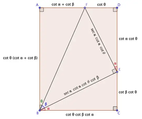

trigonograph for cot
Similarly, let $FD=\cot\theta$, and let the magic happen...

  • Nice! This is exactly the kind of thing I was looking for. I'm going to try to use it as inspiration to try developing a geometric proof of the cotangent identity as well. Unless you have that one hanging around as well? – Ted Hopp May 21 '21 at 13:31
  • @TedHopp I have also added a diagram for cotangent, hope you like it. – krazy-8 May 22 '21 at 05:18
    Thanks again. I hadn't had a chance to try my hand at a proof, and now I don't need to. :) – Ted Hopp May 23 '21 at 01:20
