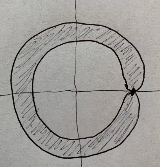

The cylindroid C need not be a manifold with corners. Here's a sketch of a counterexample (different from the incorrect one I posted earlier). Forgive my crude drawings.
Begin with a surface in $\mathbb R^3$ that's diffeomorphic to a disk. Looking down on it from the positive $z$-axis, its projection on the $xy$-plane looks like this: enter image description here But in 3-d, it actually lies on the surface of a helicoid, so as you walk counterclockwise around the surface, you gradually rise one unit in the $z$-direction. The darkened point on the positive $x$-axis actually represents two points on the surface, with one of them $1$ unit above the other.

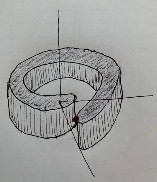

Now let $\gamma:[0,1]\to \mathbb R^3$ be the curve $\gamma(t) = (0,0,t)$. The cylindroid $C$ is thus obtained by taking this helicoidal surface and translating it directly upward one unit. The resulting solid figure looks roughly like this: enter image description here The red dot is the point where the original surface meets its translated version. There is no neighborhood of the red dot in $C$ that is homeomorphic to an open subset of $\mathbb R^3$ or of $H^3_k$ for any $k$.
ADDED: Assume for contradiction that $C$ is a manifold with corners. Since some points of $C$ have neighborhoods homeomorphic to open balls in $\mathbb R^3$, it must be $3$-dimensional by invariance of dimension. Our assumption implies that there is a (relative) neighborhood $U$ of the red point in $C$ and a homeomorphism $\varphi\colon U\to \widehat U$, where $\widehat U$ is an open subset of $\mathbb R^3$ or of $H^3_k$ for some $k$. By shrinking $U$ and $\widehat U$ if necessary, we can assume both are connected. Shrinking further, we can assume that $U$ is contained in the ball of radius $1/8$, say, around the red point.
Now let $q = \varphi(\text{red point})$. Then $\widehat U\smallsetminus\{q\}$ is connected, but $U\smallsetminus \{\text{red point}\}$ is disconnected. Since homeomorphisms preserve connectivity, this is a contradiction.

  • Hi professor, first of all I thanks you to have replied at my appel: thanks very much really. Unfortunately I do not understand one thing about the counterexample: in the question $M$ is a $(n-1)$-manfiold in $\Bbb R^n$ and in your counterexample it seems to me that it is $n=3$ but the dimension of $M$ is $(n-2)$ and thus consequentially I do not understand all other things too. So where is my mistake now? Could you illuminate me about, please? Excuse me for the confusion. – Antonio Maria Di Mauro May 23 '21 at 16:19
  • @AntonioMariaDiMauro: Sorry, I missed that part of your hypothesis. But the claim is still false. I'll edit my answer. – Jack Lee May 23 '21 at 16:29

  • Okay, I see. So substantially the cylindroid of your counterexample is not a manifold because at the red point is not defined a tangent space in the boundary, right? – Antonio Maria Di Mauro May 26 '21 at 20:40
    Well, it's even more fundamental than that -- it doesn't really have anything to do with tangent spaces or differentiation. The red point has no neighborhood that is homeomorphic to an open subset of $\mathbb R^3$ or $H^3_k$. One way to see it is that if $U$ is an open subset of any of those model spaces, then it remains connected if you remove a single point. But if $U$ is a small neighborhood of the red point and you remove the red point, then the rest of $U$ becomes disconnected. – Jack Lee May 26 '21 at 20:47
    It doesn't really make sense to ask whether a set "has a tangent apace" unless you already know it's a manifold. – Jack Lee May 26 '21 at 20:47
  • Pheraps I understood: you want say that the immage of $U$ is disconnected because the red point not lies to it and so this really impossible since the immage of $U$ is homeomorphic to $U$, right? – Antonio Maria Di Mauro May 26 '21 at 20:51
  • I didn't quite follow this comment. But I'll add a more careful version of the argument to my answer. – Jack Lee May 26 '21 at 20:54
