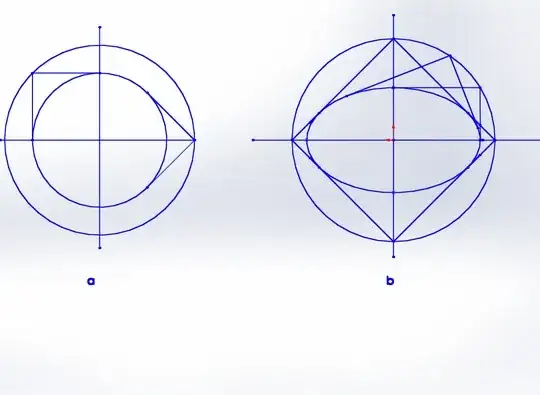

Hints:
As comment by Inteligenti, the locus of theses points is a circle, In figure a a circle is shown and in b an ellipse as a compressed circle. The radius of locus for circle is $R=\sqrt 2 r$ where r is the radius of circle.For ellipse $R=\sqrt {a^2+b^2}$. So if you want to find in your own way this must be final result.
