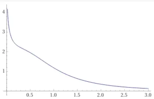

I've tried to calculate this and it appeared very difficult. The plot of the integrand doesn't look very extraordinary.
orginal_function_plot

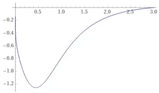

This is interesting by itself, since the integrand displays interesting shape with two inflection points of the first derivative. I wouldn't expect it to be equal to $\pi$ (yet the algebra clearly shows that it is).
pi_part_of_integral_plot

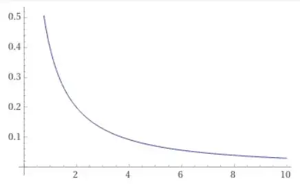

which follows from \eqref{eq1} and \eqref{eq2}. This is correct (I've checked numerically with relatively high precision of ~100 decimals). It seems very hard to prove though. The plot of the integrand doesn't appear to suggest any trivial solution: zero_integral_function_plot
