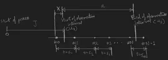

This is what our observation of the point process looks like. We go from the start of it to some time $J$ and take an interval of size $u$ starting there. The end of the observation interval is labeled $u_2$ and the start of it is labeled $u_1$.
We label the point lying just before our interval started "#$0$", the first point inside our observation window "#$1$" and so on until the last point in our observation window which is "#$N$" (so, we have $N$ points lying inside our observation window). The point lying just outside our observation window is "#$N+1$". The inter-arrival time between event #$i$ and #$i+1$ is $t+\epsilon_i$ where $t$ is the mean time between arrivals for our point process. Again, all we know about the $\epsilon_i$'s is that their means are $0$ and their domains are $(-t, \infty)$.

Per the figure above, the random variable denoting the time between the start of the interval and the occurrence of event #$1$ is $X$. We count the first event and the time in our interval left after it is $V-X$ (in the modified point process). And we have established that event #$2$ happens $t$ after event #$1$ and so on. So, the number of events inside our interval in the modified point process becomes:

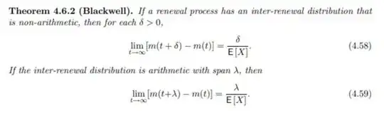

Someone pointed me to a very relevant theorem from renewal theory:
Can be found here. This is the same as my conjecture, only being a little more general in how the start of the interval is chosen.
The requirement that the process be "well into its lifetime" is key to fixing the proof.
In the version in the question, the $\epsilon_0$ is multiplied with $U$ and this makes the result we're using inapplicable. But instead, we can simply move $u_1$ forward by $\epsilon_0$, doing the same for event #0. And since $\epsilon_0$ is also zero-mean, the result used in the proof will apply and it should hold.
Note that the proof assumed nothing about the correlations between $\epsilon_0$, $\epsilon_1$ and so on. So, it should hold for most point processes, not just renewal processes. And I've verified this with simulations. Also see here: Prove that $\lim_{m \to \infty} (\lceil m U \rceil -mU ) \sim U(0,1)$
