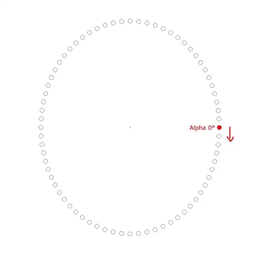

I can draw ellipses nicely with this formula
 alpha = 0-360 °
 x: = width * Cos (alpha)
 y: = height * Sin (alpha)
The first point (alpha = 0 °) is to the right of the center point:

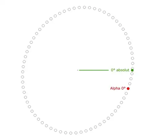

and rotate the ellipse at the same time with this formula:
 alpha = 0-360 °
 beta = 20 ° inclination
 x: = width * Cos (alpha) * Cos (beta) - height * Sin (alpha) * Sin (beta)
 y: = width * Cos (alpha) * Sin (beta) + height * Sin (alpha) * Cos (beta)
Source: What is the parametric equation of a rotated Ellipse (given the angle of rotation)
When you turn, you also turn the coordinate system of the ellipse. The point alpha = 0 is now 20 ° below the center.
I'm trying to get points in the rotated ellipse with absolute angles. The green dot.
Maybe someone knows how to do it.

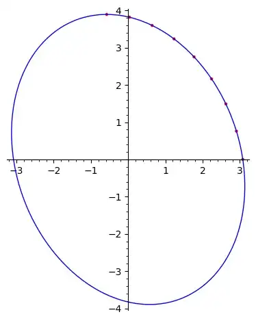

Here's some Sage / Python code that uses those equations to plot the ellipse, and several dots with $\alpha$ in the range $[0, \pi/2]$.
@interact
def main(w=3, h=4, b=20):
    b *= pi / 180
    cb, sb = cos(b), sin(b)
    d = atan2(-w * sb, h * cb)
def fx(t):
    return w * cos(t+d) * cb - h * sin(t+d) * sb
def fy(t):
    return w * cos(t+d) * sb + h * sin(t+d) * cb
P = parametric_plot([fx, fy], (0, 2*pi))
P += point([(fx(t), fy(t))
    for t in srange(0, 9*pi/16, pi/16)], color="red")
show(P)
Here's a live version, running on the SageMathCell server.
And here's the output, with the default parameters.
Rotated ellipse
