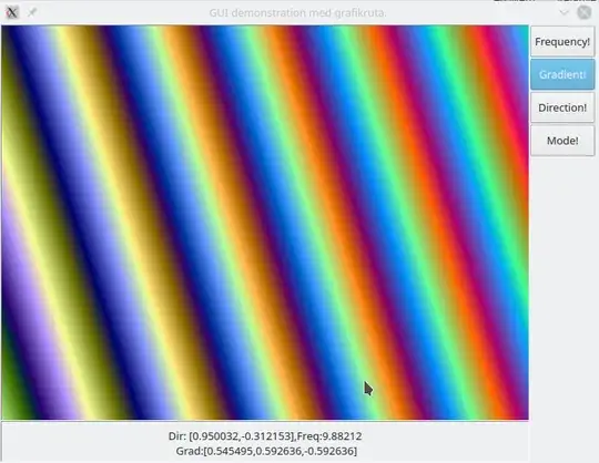

Background : The other day I felt like updating my knowledge with GUI programming so I made a small application that rendered a multivalued periodic function $\mathbb R^3 \to \mathbb [0 ,255]^3$. The three in-dimensions being $(x,y,t)$ and the three out-dimensions $(R,G,B)$.
The problem I encountered was that my math librarys "sin" routine which I had intended to use was too slow. I instead tried a sawtooth-like approximation using round, and fabs which was much faster but not nearly as pretty.
How can I make a computationally cheap but still relatively smooth sine-like curve for purposes like this?
