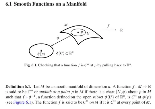

I have a question about the definition of smooth function defined on a manifold, as described in An Introduction to Manifolds by Loring W. Tu. In the book is the following definition:
So if we set $M=\Re$, $p=0$ and $U=(-1, 1)$. Pick $f = x/2$ when $x \lt 0$, $f = x$ when $x \ge 0$. Then if we define $\phi = f$, we obtain $f \circ \phi^{-1}= 1$. I believe the choice of $\phi$ is valid, as is a homeomorphism.
According to the definition, since $f \circ \phi^{-1}$ is smooth, then $f$ is smooth. But clearly $f$ is not smooth!
Please can someone clarify where my understanding is wrong?

    Possibly of interest. The point is, smoothness isn't an intrinsic property of a function, it's a property of a function with respect to an atlas. Your proposed chart is not compatible with the identity map. That's fine, it just means you can't use "non-smoothness of $f$ with respect to the standard coordinate" to deduce that "$f$ is not smooth". In the maximal atlas compatible with $\phi$, $f$ is smooth. – Andrew D. Hwang May 05 '21 at 19:42
  • Thanks @andrew, this makes sense! I wish the book had mentioned that smoothness is specifically wrt a chart. Although it’s perhaps implicit, it’s not necessarily obvious. Thank you! – Martin W May 06 '21 at 05:51

You are confused by the word chart. In § 5.1 Tu introduces the concept of a topological $n$-manifold $M$ and defines a chart on $M$ to be any pair $(U,\phi)$, where $U \subset M$ is open an $\phi : U \to V$ is a homeomorphism onto an open $V \subset \mathbb R^n$. For the sake of precision let us call this a topological chart on $M$.
In § 5.3 he introduces the concept of a smooth $n$-manifold. This is a topological manifold $M$ together with a differentiable structure. The latter is a maximal atlas $\mathfrak D$ with $C^\infty$-transition functions between all charts in $\mathfrak D$. At the end of § 5.3 Tu explicitly says
From now on, a “manifold” will mean a $C^\infty$ manifold. We use the terms “smooth” and “$C^\infty$” interchangeably. [...] By a chart $(U,\phi)$ about $p$ in a manifold $M$, we will mean a chart in the differentiable structure of $M$ such that $p \in U$.
Of course there are many more topological charts on $M$, but if such a chart does not belong to differentiable structure, then Tu does not use it.
This is what you do: Your chart $\phi = f$ is a topological chart not belonging to the standard differentiable structure of $\mathbb R$. You can use this chart to endow $\mathbb R$ with a non-standard differentiable structure, and with respect to it the map $f$ is smooth.

  • Thanks @Paul. This is really helpful! The reason for my question was because I don’t believe Tu requires $\phi$ to be smooth, which led me to a strange (in my mind) example of a ‘smooth’ function. But as you have explained, the key point is that my function $f$ is smooth wrt the atlas I have defined. – Martin W May 06 '21 at 07:39
