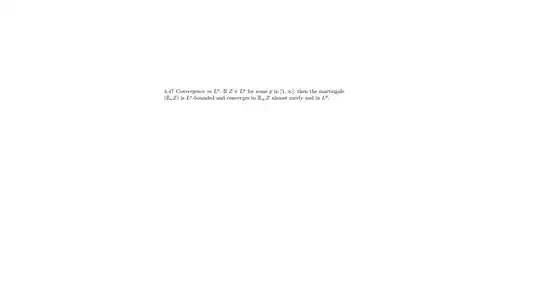

It seems we also have convergence in $L^{\infty}$ (mentioned in a book on stochastic processes), Why is this true ? Of course it's easy to see that $||E[X|\mathcal{F}_k]-E[X|\mathcal{F}_{\infty}]||_{\infty} \leq ||E[X|\mathcal{F}_k]-X||_{\infty},$ do not know if it's helpful. The $L^{\infty}$-convergence question is taken from probability and stochastics:enter image description here

The $L^\infty$ statement is definitely not true. For instance, take $\Omega = (0,1]$, and let $$\mathcal{F}_n = \sigma(((k-1)2^{-n}, k2^{-n}] : 1 \le k \le 2^n)$$ be the filtration generated by intervals whose endpoints are multiples of $2^{-n}$, so $\mathcal{F}$ is the Borel $\sigma$-algebra. Let $P$ be Lebesgue measure. Note every $\mathcal{F}_n$-measurable random variable is a step function. Now let $X = 1_A$ where $A$ is a Borel set that has positive but not full measure in every interval; see Construction of a Borel set with positive but not full measure in each interval. Then $X$ is $\mathcal{F}$-measurable, but $\|X - E[X \mid \mathcal{F}_n]\|_{L^\infty} \ge 1/2$ for every $n$.
Alternatively, note that the space $L^\infty(\mathcal{F}_n)$ of bounded $\mathcal{F}_n$-measurable functions is finite dimensional and thus separable in the $L^\infty$ norm. If your claim were true then $\bigcup_n L^\infty(\mathcal{F}_n)$ would be dense in $L^\infty$ and thus $L^\infty$ would be separable, which it isn't.
Or, if you want a more probabilistic example: suppose we have a sequence of independent biased coin flips, where $A_n$ is the event that the $n$th coin is heads. Suppose that $P(A_n) > 0$ for all $n$ and that $\sum_n P(A_n) < \infty$. Let $Y = \sum_n 1_{A_n}$ be the total number of heads observed; by Borel-Cantelli $Y < \infty$ almost surely. Let $X = 1$ on the event that $Y$ is odd and $0$ otherwise. If $\mathcal{F}_n = \sigma(A_1, \dots, A_n)$ is the natural filtration, then it is clear that on each nonempty event in $\mathcal{F}_n$, the random variable $X$ takes both values 0 and 1 with positive probability (no matter how the first $n$ flips came out, the remaining number of heads could be either even or odd and thus both parities are still possible for $Y$). So the $L^\infty$ distance between $X$ and any $\mathcal{F}_n$-measurable random variable must be at least $1/2$.
So the claim from the book (could you give the complete citation?) seems to be an error.

  • Is it a possible typo ($L^{\infty}$-convergence) ? In case $X \geq 0,$ then $E[X|\mathcal{F}_k]$ converges a.s (nonnegative supermartingale) – Kurt.W.X Apr 19 '21 at 18:21
  • @Kurt.W.X: Yes, I think the claim of $L^\infty$ convergence must be a typo. – Nate Eldredge Apr 19 '21 at 21:16
