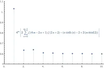

Graphical Verification
Plotting $4^m$ times the absolute error of the approximation given in $\text{(5d)}$ shows that it is bounded and appears to tend to a limit around $0.6$.
