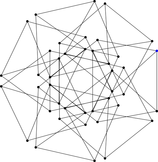

I have found the following unit-distance embedding of the cubic symmetric graph $F_{42}A$ with $D_7$ symmetry. (Gerbracht's embedding on the MathWorld page for cubic symmetric graphs is only of $C_7$ symmetry; for embeddings of other cubic symmetric graphs see my Shibuya repository.)

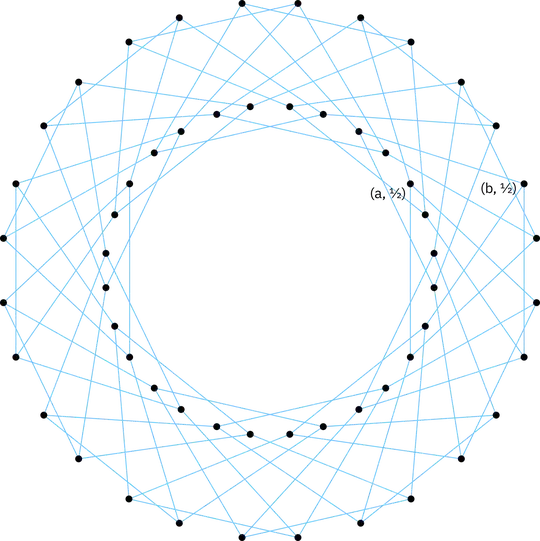

Let the blue vertex above have coordinates $(a,\frac12)$, which with $D_7$ symmetry determines the rest of the graph. $a$ must satisfy the following sextic over $\mathbb Q[t]$: $$256 a^{6} + a^{5} \left(16 t^{5} - 320 t^{3} + 304 t\right) + a^{4} \left(- 16 t^{2} - 144\right) + a^{3} \left(- 32 t^{5} + 656 t^{3} - 912 t\right) + a^{2} \left(- 4 t^{4} + 112 t^{2} - 188\right) + a \left(7 t^{5} - 136 t^{3} + 57 t\right) - t^{4} + 13 t^{2} + 14=0\tag1$$ where $t=\tan\frac\pi7$. This suggests that there should be six algebraically related $D_7$ embeddings, but the above polynomial has only two real roots, leading to two embeddings: the one above and the one below.
In the spirit of what I did at the end of this other answer, I want to see whether I can factor $(1)$ further to obtain a quadratic whose roots are the two real solutions for $a$ ($a=0.27455\dots$ in the first picture and $a=1.24353\dots$ in the second). Normally I would use GAP's DecomPoly for this, but it only accepts polynomials over $\mathbb Q$ and not any extension of it, and certainly feeding it the degree-$36$ polynomial that $a$ satisfies over $\mathbb Q$* would take too long.

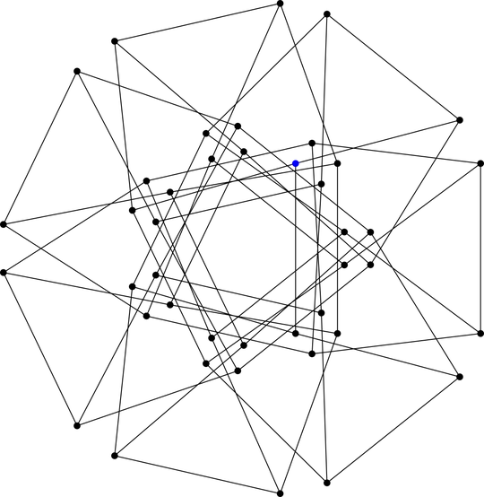

The resolvent method for determining Galois groups works over any field – not just $\mathbb Q$ – and is enough to solve this question. To illustrate how consider coordinate values $a$ and $b$ in the following unit-distance embedding of $F_{56}A$ with $D_{14}$ symmetry:
$a$ and $b$ satisfy $$a^{4} \left(16 t^{4} + 16 t^{2}\right) - 64 a^{3} t^{3} + a^{2} \left(- 8 t^{4} + 24 t^{2}\right) + 16 a t + t^{4} + 5 t^{2} - 4=0\\ b^{4} \left(16 t^{4} + 16 t^{2}\right) + 64 b^{3} t^{3} + b^{2} \left(- 8 t^{4} + 24 t^{2}\right) - 16 b t + t^{4} + 5 t^{2} - 4=0$$ where $t=\tan\frac\pi{14}$. To compute the resolvent polynomial in $\mathbb Q[t][y]$ exactly I use Stauduhar's method of computing its coefficients numerically to high precision and "rounding" them to the nearest element in $\mathbb Q[t]$ – where rounding means applying an integer relation algorithm. Concretely, using mpmath and SymPy for the resolvent of the $a$-polynomial with respect to $x_1-x_2$:
