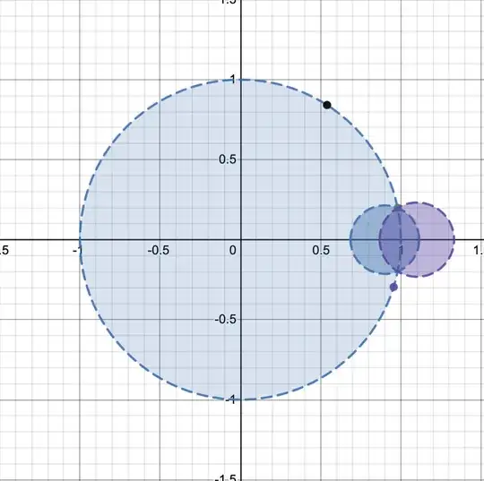

Edit 2: This is what I have so far for iterating the Taylor series. If the Taylor series for $f(x)$ is $$T_1(x)=\sum_{n=0}^\infty \frac{f^{(n)}}{n!}\left(0\right) x^n$$ and the radius of convergence is R, then we can center $T_2(x)$ around $x=\frac{9}{10}R$, since that is within the area of convergence. We get that $$T_2(x) = \sum_{n=0}^\infty \frac{T_1^{(n)}}{n!}\left(\frac{9}{10}R\right) x^n = $$ $$T_2(x) = \sum_{n=0}^\infty \left(\frac{\sum_{k=n}^\infty \frac{f^{(k)}\left(0\right)}{k!} \frac{k!}{(k-n)!} \left(\frac{9}{10}R\right)^{k-n}}{n!}\right) x^n = \sum_{n=0}^\infty \left(\sum_{k=n}^\infty f^{(k)}\left(0\right) \frac{1}{(k-n)!n!} \left(\frac{9}{10}R\right)^{k-n}\right) x^n $$ and in general centered around $x_{center}$ $$T_{w+1}(x) = \sum_{n=0}^\infty \frac{T_w^{(n)}\left(x_{center}\right)}{n!} x^n$$ I tested this out for ln(x), and it seemed to work well, but I suppose it could fail if taking the derivative of $T_w(x)$ too many times causes $T_w(x)$ to no longer match $f(x)$ closely.
I tested out this method of extending a function with Desmos, here is the link if you would like to test it out: https://www.desmos.com/calculator/fwvuasolla
Edit 3: I looked in analytic continuation some, and it looks like the method I was thinking of that extends the range of convergence using the old coefficients to get new ones is already a known method, though it uses Cauchy's differentiation formula so it is able to avoid some of the convergence problems that I was worried about before that comes from repeated differentiation. So, it appears there should exist some way to overload the sum operation that achieves this same continuation. I suppose there's the trivial option of defining summation as the thing which returns the same values as continuation would return, but that's a very unsatisfying solution. It would be interesting to see if it's possible to create a natural generalization of summation that agrees with this method of continuation.
Edit 4: I think I may have found a start for how to extend the convergence of all Taylor series which can be extended. Based on my above argument of recursively applying the Taylor series, one algorithm could go as follow:

Final Edit: I think I figured it out! The result is (for analytic f(x)) that $$f(x) = \lim_{dt \to 0}\sum_{n=0}^\frac{x}{dt} \frac{(dt)^n}{n!} f^{(n)}(0) \prod_{k=0}^{n-1} \left(\frac{x}{dt}-k\right)$$ For $f(x) = \frac{1}{1-x}$ this becomes $$\lim_{dt \to 0} e^{\frac{1}{dt}}dt^{-\frac{x}{dt}}\int_{\frac{1}{dt}}^{\infty}w^{\left(\frac{\left(dt-x\right)}{dt}-1\right)}e^{-w}dw$$ which does indeed converge to $\frac{1}{1+x}$ for $(-1,\infty)$. Thanks for everyone's help in getting here! I'm going to work next on seeing if allowing dt to be a function of the iterations allows one to extend this method to get analytic continuations of functions which have boundaries that are dense but not 100% dense, since my thought is that maybe after an infinite number of steps its possible to squeeze through the 'openings' in the dense set.
