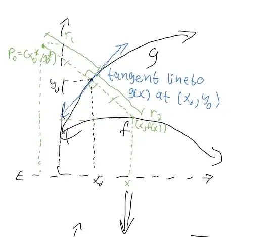

Let’s think about splitting each “revolution” of a point around another point as one revolution. I believe one great way to see this would be to choose a point $(x_i,y_i)$ and draw the tangent line at that point to the axis.
Afterwards, the normal line to the point would be drawn until it intersects the other relation. The length of this line would be r and so would the line in the other direction extending to the other side of the tangent line. I apologize if my diagrams are a bit unprofessional: enter image description here

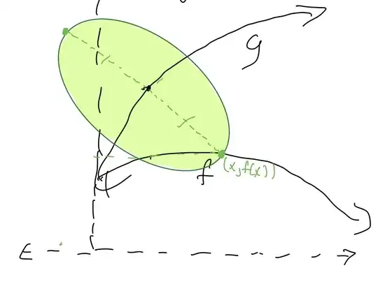

Following from the rest of the diagram, the diameter can be used to draw a circle, or ellipse from this point of view: enter image description here
Completing this process for every point on the relation axis would get us the unfilled and hollow surface of $\operatorname{Rev}(f,g)$.

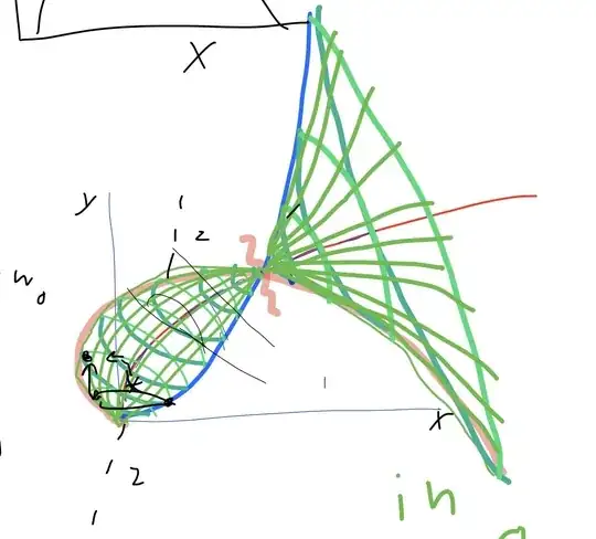

Here is what the revolution of $\sqrt x and x^2$ would look like or $\operatorname{rev}(x^2,\sqrt x)$: enter image description here

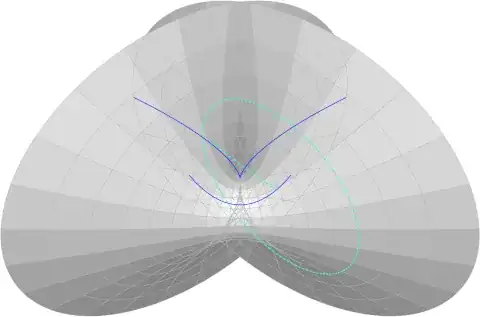

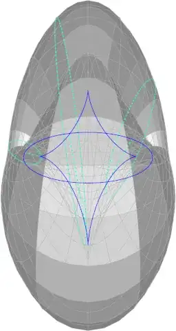

In the examples shown, $f$ is taken to be the evolute of $g$, so that $s = t$ and $a(t) = \|g(t) - f(t)\|$.
$g(t) = (t, t^{2})$ the standard parabola, $f(t) = (-4t^{3}, \frac{1}{2} + 3t^{2})$ a cubic cusp:
Revolving a cusp about a parabola
$g(t) = (a\cos t, b\sin t)$ an ellipse, $f(t) = \frac{a^{2} - b^{2}}{ab}(b\cos^{3}t, -a\sin^{3} t)$ an astroid:
Revolving an astroid about an ellipse
