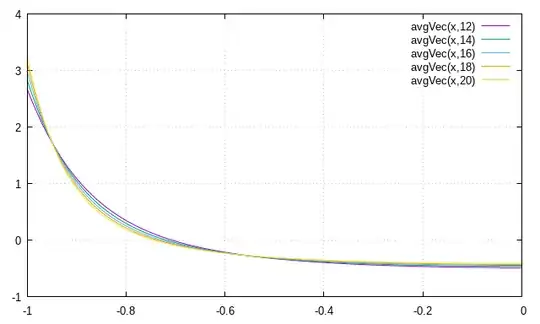

I've tried to construct an average vector by adding the non-orthogonal vectors together in proportion to the value shown in the list. eg: in proportion to the cosine() of the angle between vectors. I'm not sure this is a good choice, but it has the virtue of emphasizing the importance of lower order vectors in the average. In infinite series, convergence is determined by the error of higher order terms going to zero .. so this DE-empahasizing higher order terms in the average seems logical. But, again,it's an arbitrary attempt.
None the less, I graphed the normalized results of the averaging, and I get a graph which suggests that the process is converging in certain parts of the graph. I believe that convergence is what linear dependence is all about in this graph ... and represents non-orthogonality in my basis set. (Am I in error?)
But, I don't quite see a practical way of determining an analytical function from my graph.Such a function would be useful as a first vector in a Grahm-Schmidt orthogonalization process.

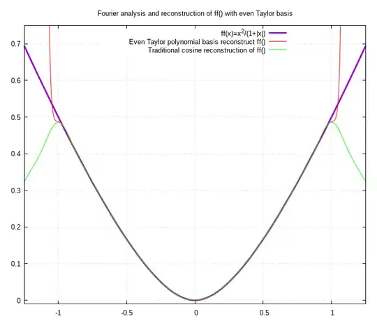

Next, I need to show the reconstruction of ff() by the Fourier method.
If the Taylor polynomial of ff() is unique in the sense that the function
ff() can not be reconstructed from even powered cosine functions because
a counter-example Taylor series exists with odd powers (see answer post) ...
then this composed polynomial should not converge to the ff().
Otherwise, Taylor series 'uniqueness' is a not a strong argument by itself.
array composedC[ORDC] = [0,0,0,0,0,0,0,0,0,0,0,0,0,0,0,0,0,0,0,0,0,0,0,0,0,0,0,0,0,0,0,0,0,0,0,0,0,0,0,0,0,0,0,0,0,0,0,0,0,0,0,0,0,0,0,0,0,0,0,0,0,0,0,0,0,0,0,0,0,0,0,0,0,0,0,0,0,0,0,0]
k0 = ff_a0/2. do for [ ff_n =1:NA ] { # 10 Fourier coefficients k0 = k0 + ff_aN[ ff_n ]cos_c0 do for [co=1:ORDC] { # Composite Taylor series coefficients. composedC[co]=composedC[co] + ff_aN[ ff_n ]cos_cN[ co ](piff_n)**co if (ff_n==1 && co<10 && composedC[co]!=0 ) { print composedC[co] } } }
The standard Fourier composition for reference / comparison:
reComposeC(x,N) = ff_a0/2 + sum [ff_n=1:N] ff_aN[ff_n]cos(ff_npi*x)
The Taylor series expansion of the fourier composition is simply:
reComposeT(x) = k0 + sum [n=1:ORDC] composedC[n]* (x)**n
print sprintf("ff() re-composed by Taylor polynomial coefficients") do for [i=0:10] { # show the first 10 coefficients. if (i==0) { coeff=k0 } else { coeff=composedC[i] } print sprintf( "%+.4e x^%d ", coeff, i ) }
set title "Fourier analysis and reconstruction of ff() with even Taylor basis" set samples 1000 set key top center set xrange [-1.25:1.25] set yrange [-0.01:0.75] set grid
plot
x**2/(1+abs(x)) lw 3 ti 'ff(x)=x^2/(1+|x|)',
reComposeT(x) lc '#FF0000' ti "Even Taylor polynomial basis reconstruct ff()",
reComposeC(x,NA) lc '#00FF00' ti "Traditional cosine reconstruction of ff()"

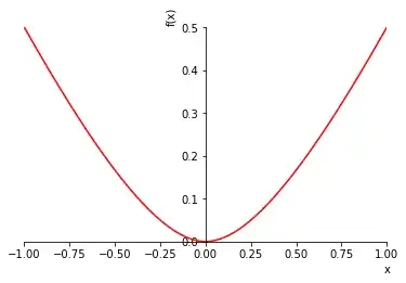

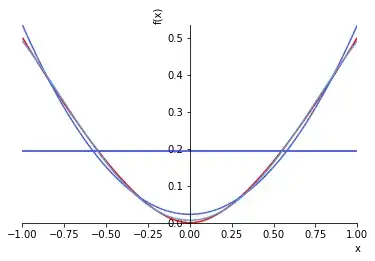

Here are plots of the original function $x^2/(1+|x|)$ in red, and then the first three approximations, and finally the difference between $x^2/(1+|x|)$ and the 20th approximation:
enter image description hereenter image description hereenter image description here
I did the above in a jupyter notebook; I didn't bother arranging it nicely but the following should be enough to reproduce the plots
f = x**2/(1+abs(x))
coeffs=[]
for j in range(20):
    coeffs.append(integrate(f*legendre(j,x),(x,-1,1))/(integrate(legendre(j,x)**2,(x,-1,1))))
approx = [sum([coeffs[j]*legendre(j,x) for j in range(k)]) for k in range(20)]
p1=plot(f,(x,-1,1),line_color=(1,0,0))
for j in range(1,4):
    p2=plot(approx[2*j],(x,-1,1),show=False,line_color=(j/8,j/5,1-j/20))
    p1.append(p2[0])
p1.show()

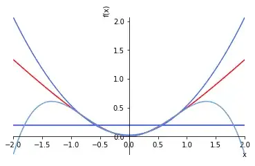

Also, here's another plot showing the bad behavior outside of $(-1,1)$: enter image description here
