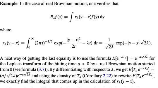

How to get the following for $a,b>0$? $$\int_0^\infty\frac{1}{\sqrt{2\pi t}}\cdot\exp\bigg({\frac{-a}{2t}-bt}\bigg)dt=\frac{1}{\sqrt{2b}}\cdot \exp\big(-\sqrt{2ab}\big) $$
The context for this identity is its use in computing the resolvent of Brownian motion in the stochastic calculus book by Le Gall (screenshot below). I figured there had to be an elementary way to compute it, i.e. without using the fact Le Gall alludes to about the Laplace transform of the hitting time of Brownian motion. As is indicated in the comments, this is clearly a duplicate so I wouldn't object to its being closed for that reason. Although maybe those who posted the excellent answers below should've been given the chance to migrate their answers to the post of which this is a duplicate, if they wish. enter image description here
