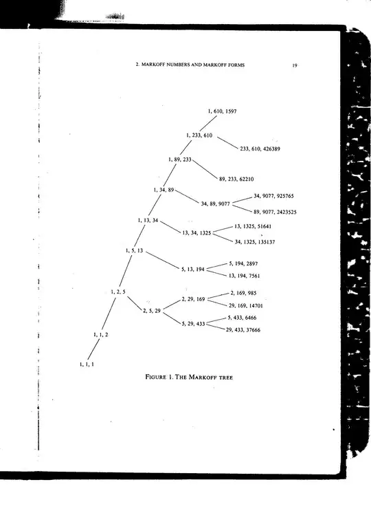

There are many such properties involving the Markov numbers, see also OEIS, which together make up a tree rather than a single sequence. The numbers are any of the variables (required to be positive integers) in $$ x^2 + y^2 + z^2 = 3 x y z. $$ Your sequence $1,2,5,29,433,37666,48928105,\ldots$ is the fastest growing branch in the tree, in that you are replacing (jumping out) the smallest number in the current triple. The slowest growing branch is the Fibonacci numbers with odd index $1,2,5,13,34,89,233,610,1597,\ldots,$ in that the middle-sized number in the triple is replaced. See jpeg far below. Oh, if you replace the largest number in the triple, you jump back closer to the root. Travel within the tree is one of the more serious uses of Vieta Jumping. The other serious use, with recent articles in the AMS Bulletin by Kontorovich and by E. Fuchs, is Apollonian Gaskets. I would like to put, at a minimum, Wikipedia links at Vieta Jumping and Apollonian Gaskets pointing to each other, but I have had little luck with Wikipedia and the relationship has not been noticed in print.

This is page 19 from Cusick and Flahive

    In case anyone else looks at this, note that it is a theorem, requiring proof (but not difficult), that all solutions of the Markov equation occur in a single tree, with root (1,1,1). Adolf Hurwitz considered the analogous problem with $n$ variables in 1905. Beginning with $n \geq 14,$ sometimes there is more than one tree. – Will Jagy Jun 03 '13 at 20:12
