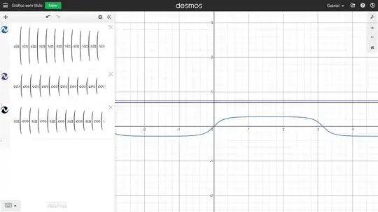

I was playing around with desmos, when i saw this
I think that:
  • $\sin(\sin(\sin(\cdots)))$ will approach zero veeeery slowly, also approaching a square wave.
  • $\cos(\cos(\cos(\cdots)))$ will approach $0.7389$.
  • $\sin(\cos(\sin(\cos(\cdots))))$ will approach $0.948$.
Are these hypothesis correct? Is there any formal proof?

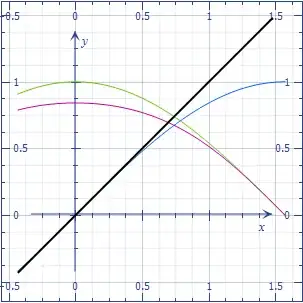

Here is a plot of your $f$'s, which confirm the values you found:
A convergence criterion is $|f'(x)|<1$, which is achieved by your last two functions. Convergence is linear (the number of exact digits grows proportionally to the $n$).

  • is there any explanation of why sin(sin(sin... approaches c*|sin(x)|/sin(x) with c tending to zero? – gdor11 Mar 29 '21 at 14:35
  • @Gabriel: the sine being an odd function, the sign is preserved. –  Mar 29 '21 at 14:43
  • but why not something like c*sin(x)? or any other function that preserves sign and approaches zero? – gdor11 Mar 29 '21 at 14:49
    @Gabriel: as you can check, the derivative of the iterated functions become smaller and smaller, giving a flatter and flatter curve. (Anyway, the derivative remains $1$ at $x=0$.) –  Mar 29 '21 at 15:05
