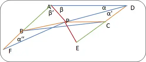

Let us take advantage of |AD|=|AB|+|CD| by extending AB to F, DC to E, so that $BF=CD, CE=AB, \color{orange}{AF= ED=AD}$.
Now, we have 3 sets of congruent triangles to play with.
$\triangle DPA\cong \triangle DPE (\color{orange}{AD=ED}, \alpha =\alpha',PD=PD)$, $\color {blue}{PA=PE}$.
$\triangle PAF\cong \triangle PAD (\color {blue}{PA=PE}, \beta =\beta',\color{orange}{AF=AD}), \color {green}{PF=PD}, \alpha=\alpha''$.
$\triangle PBF\cong \triangle PCD (\color {green}{PF=PD}, \alpha =\alpha'',BF=CD)$
\begin{align}\boxed {PB=PC}\end{align}

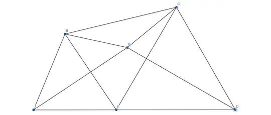

Quadrilateral ABCD
Let point $E$ be on $AD$ between $A$ and $D$ such that $AE=AB$. This automatically fixes $DE=CD$.Draw $BE$ and $CE$.
$\triangle ABE$ is isosceles and $AP$ bisects $\angle BAE$, hence $AP$ is the perpendicular bisector of $BE$. Similarly, it can be concluded that $PD$ is the perpendicular bisector of $CE$.
In $\triangle BCE$, the perpendicular bisector of $BE$ and $CE$ meet at point $P$. Hence, $P$ is the circumcentre of $\triangle BCE$ and thereafter $BP=CP$
