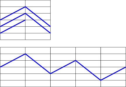

I made a picture following the sketch of Brian Rushton at the post linked by Ross Millikan. More generally, if you want to avoid having $f(x)=f(x+a)$ where $0<a<1$ is not of the form $\frac{1}{n}$, the idea would be to take the quotient of the $x$-axis by $a \mathbb{Z}$ and draw the graph on the resulting cylinder.

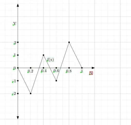

Either way I'll just write an explicit function as an answer for this problem: $f(x) = \begin{cases} -10x &, x \in [0,0.2) \\ 1 + 15(x-0.4) &, x \in [0.2,0.4) \\ 1 -10(x - 0.4) &, x \in [0.4,0.6) \\ 2 + 15(x-0.8) &, x \in [0.6,0.8) \\ -10(x - 1) &, x \in [0.8,1] \\ \end{cases} $
The above function $f(x)$ is just a bunch of alternatively parallel line segments joined at the endpoints. It satisfies the property: $$x \in [0,0.6] \Rightarrow f(x + 0.4) = f(x) + 1$$ A plot for f(x) is given by: enter image description here

    I gave +1, but this is pretty much the same plot I put in my answer! Observation that $f(x+0.4)=f(x)+1$ is nice. – Mike F Mar 28 '21 at 02:25
  • Hey, I realize you have the 'cylinder ' approach to plotting the curve. But user21820's answer to that problem on the link in my answer describes a slightly different method of construction which allows us to find $f$ s.t. $f(x+0.4) = f(x) + c$ for any constant $c$. – Anon Mar 28 '21 at 03:44
