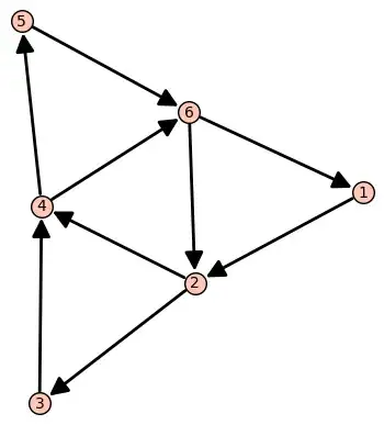

I am working with SageMath on graphs, in particular on this graph:
I have found that its automorphism group is generated by the elements $(1,3,5)$ and $(2,4,6)$: how do I find to which group is this group isomorphic to? I ask both computationally and mathematically.

    Something seems off about this. Ordinarily $(1,3,5)$ would stand for the permutation that takes $1$ to $3$, takes $3$ to $5$, takes $5$ to $1$, takes $2$ to itself, takes $4$ to itself, and takes $6$ to itself. Are you sure that this is an automorphism of the graph? – Lee Mosher Mar 25 '21 at 16:14
    It loos to me as though the automorphism group is generated by the single permutation $(1,3,5)(2,4,6)$, so it is cyclic of order $3$. – Derek Holt Mar 25 '21 at 17:31
The permutations $(135)$ and $(246)$ commute, so this automorphism group is just the direct product of the cyclic groups they generate, i.e. is isomorphic to $(\mathbb{Z}/3\mathbb{Z}) \times (\mathbb{Z}/3\mathbb{Z})$.

Since they are disjoint three-cycles, they commute and have order three; there are no other restrictions on the group; so the group is isomorphic to the group given by the presentation
$$\langle a,b\mid a^3, b^3, ab=ba\rangle,$$
which is $\Bbb Z_3\times\Bbb Z_3$.
Computationally, you could use GAP.
If the automorphism group is, instead, generated by $(135)(246)$, then it is cyclic and the order of the group is that of the generating element, which is three; hence it is isomorphic to $\Bbb Z_3$.
