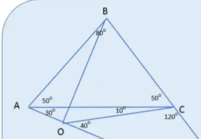

In an $\Delta ABC$ with $AB=BC$ and $\angle ABC = 80^\circ$, the point $O$ is chosen so that $\angle OAC = 30^\circ$ and $\angle OCA = 10^\circ$. Find $\angle BOC$.
I struggled repeatedly trying to solve this using some reasonable selection of methods, and failed utterly. I can construct a solution using analytic geometry, but that is not a fair choice of methods for this section.
From simple geometry, I keep writing down systems of equations using various triangles in the picture, and always keep missing one constraint, as it seems there are infinite amount of solutions to the system, which I know is wrong since the analytic geometry approach yields a unique solution.
I am happy to add my infinite solution approach using the angle constraints, if you find it helpful. Please let me know if that's the case.
I would like to solve this using methods from geometry, without using more advanced techniques. Thank you very much, I really appreciate your help.

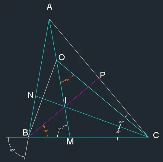

Extend $AO$ to meet $BC$ at $M$ . Note that $\widehat{AMB}=80^o$ (why?) and therefore $\widehat{MOC} = 40^o$ (why?).
Draw $BP$ , bisector of $\widehat B$ . Note that $\triangle ABC$ is symmetric with respect to $BP$ . Let $CN$ be the mirror image of $AM$ with respect to $BP$. Then $$\widehat{NCB} = \widehat{MAB} = 20^o$$ $$\widehat{NCO} = \widehat{NCA} - \widehat{OCA} = 30^o - 10^o = 20^o $$ Therefore we have: $$\triangle IOC = \triangle IBC$$ It follows that $BC = OC$, which means $\triangle COB$ is isosceles, hence: $$\widehat{BOC} = \widehat{OBC} = \frac12 (180 - \widehat{OCB}) = 70^o$$ Et voila!
Fun fact: the segments shown in cyan ($AM,CN,CO,AB,CB$) are of equal length.
Saeed
  • 2,548
    This answer could be improved more with better contrasting colors to replace the blues and greens and a white background – Some Guy Mar 25 '21 at 05:26
    Not the answer - the presentation. Very nice Saeed - confirms the GeoGebra drawing. – Moti Mar 25 '21 at 06:50
    Good answer (+1). The key constructed point is just $I$, and the diagram would be neater without the line segments $IM,IN,IP$. Thus: Let the median of triangle $ABC$ through $B$ meet $AO$ projected at $I$. By symmetry, $20^\circ=\angle IAB=\angle ICB$, and $\angle ICO=40^\circ-20^\circ=20^\circ$ too. It is similarly easy to see that $40^\circ=\angle IBA=\angle IBC=\angle IOC$. Therefore triangles $IAB$, $ICB$, and $ICO$ are congruent (ASA), and so $|CO|=|CB|$. Hence the equal base angles of the isosceles triangle $BCO$ are $70^\circ$. – John Bentin Mar 25 '21 at 09:02
  • @JohnBentin Thank you for your detailed comment. To show that $\widehat{IOC}=40^o$ I used $\widehat{AMB}$ , which is an external angle to $\triangle OMC$ and equals $\widehat{MCO} + \widehat{MOC}$ . Can you think of another way of showing $\widehat{IOC}=40^o$ without the need to construct point $M$ ? – Saeed Mar 25 '21 at 11:50
    $\angle IOC=\angle OAC+\angle OCA=30^\circ+10^\circ=40^\circ$. – John Bentin Mar 25 '21 at 14:00
  • @JohnBentin Yes, thanks, I missed that one. Always good to have a second opinion! – Saeed Mar 25 '21 at 14:38
    +1, thank you - makes a lot of sense – gt6989b Mar 25 '21 at 20:12
