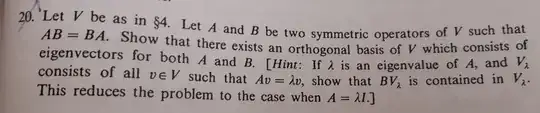

I tried to work on their matrix representations in an orthogonal basis but Spectral Theorem doesn't work out here as $A$ and $B$ are not necessarily Hermitian. When I looked for the solution, he said that by an exercise from the previous section we can find a basis of $V$ formed of eigenvectors of each operator.
The problem is that in that exercise it was given that $A$ and $B$ are real symmetric operators and thus one could use spectral theorem for the real case. That is not available here. This is the question he referred to:
How would this imply the existence of a basis of $V$ formed of eigenvectors of $A$,$B$,$A^*$ and $B^*$? Any help is appreciated!
