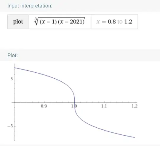

The function $f$ is given as the product of 2 functions, and it turns out that neither factor is differentiable at $x=1$. You can do the calculations yourself (you did already), but the Wolfram alpha picutures show that the root part has an "infinite" derivative:
picture of root factor of function f

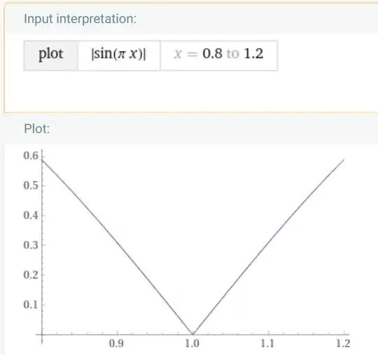

The $\sin$ part OTOH has different left and right derivates (due to the absolute value function "flipping" the sin function at $x=1$):
So you simply can't use the product rule for the function at the point $x=1$, because that requires that both functions have a derivative at that point, which isn't true. One would guess that the product of 2 such functions would then also have no derivative for $x=1$, but the above calculation shows that is not true.

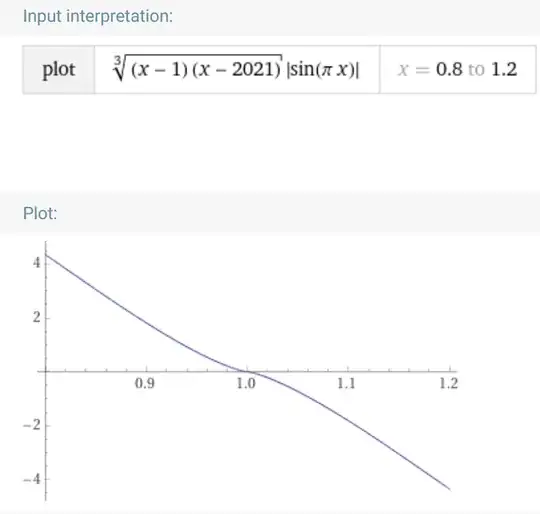

Finally, here comes the picture of how the function $f$ looks like around $x=1$:
It looks continuous, though one can't really see what the derivative at $x=1$ is, but that cleared up by the above calculation.
