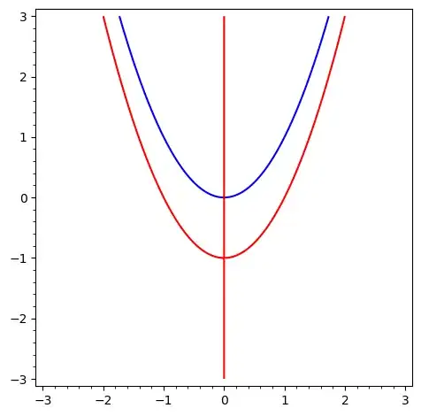

Fortunately in your example things are simple. The vanishing locus of $f_1 = x^2 - y$ is the parabola $y = x^2$, and the vanishing locus of $f_2 = x(y - (x^2 - 1))$ is the union of the $y$-axis and the parabola $y = x^2 - 1$. As you can see in the plot below, the intersection of these two algebraic sets is simply the point $(0,0)$.
$\hspace{2.5cm}$enter image description here
Algebraically, one can see this by noting that $(f_1, f_2) = (x,y)$, since $$ x = f_2 + x f_1 \qquad \text{and} \qquad y = f_1 + x^2 = f_2 + x(f_2 + x f_1) \, . $$ Thus \begin{align*} \frac{\mathbb{R}[x,y]}{(f_1, f_2)} = \frac{\mathbb{R}[x,y]}{(x,y)} \cong \mathbb{R} \end{align*} where the last isomorphism takes $x \mapsto 0, y \mapsto 0$.
