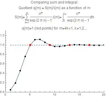

It turns out that equality seems to happen if and only if $m=4k+1, k=1,2,3...$.
This picture shows a discrete plot of the quotient $\frac{S(m)}{i(m)}$ of sum and integral.
Questions:
(1) Find all natural solutions $m$ of equation $(2)$
(2) Find an analytic continuation of $S(m)$ to real $m$ and study if the quotient $S(m)/i(m)$ is unity for other values
